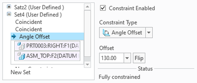

Why isn't it possible to determine the angle using the table pattern?
If possible, how can I make it work?
The 40° in the picture.

the problem is cause by prt0003.prt assembling constraints.
I uploaded modified version of prt0003.prt and modified version of prt0003.prt assembling constraints.

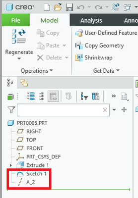

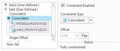

Can you explain or show in a short Video what you modified? Your modell is working but I cant reproduce it on my own.
I added two features into prt0003.prt ... see following picture
I changed assembling constraints related to prt0003.prt ... see following picture
I disabled Satz2 constraints and created new Set4 constraints.
