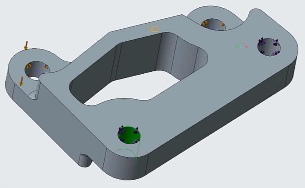

The highlighted hole can be removed while in Creo Simulate.
Remove a Feature Within Creo Simulate
To remove a feature within Creo Simulate:
  1. Using Creo FMX, highlight the feature you’ll remove.
  2. On the Refine Model ribbon bar, click Remove.
  3. Preview and/or Accept the change.

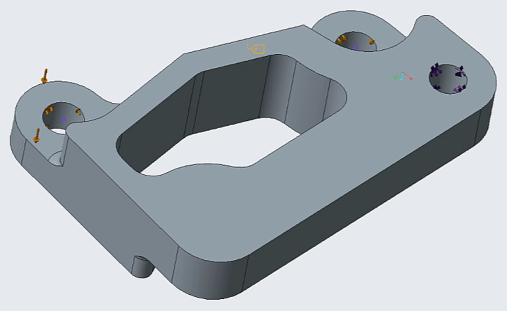

The highlighted hole (shown in the image above) is removed.
