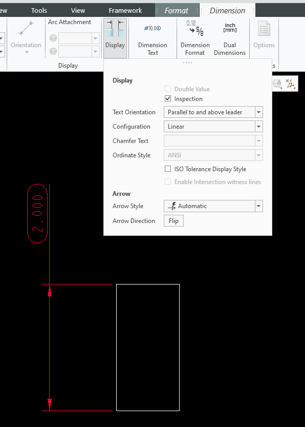

Dimension line size in inspection mode

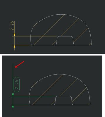

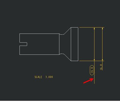

When I add an inspection circle to some dimensions, the dimension line extends more than required. In the following figure, this condition is shown, could anyone help me adjust it (PTC Creo 2)?

Figured it out its "dim_text_gap", your settings have 5, I am using 1

I am not able to reproduce that in Creo 9. Is it possible to share a simplified model with the issue?
Hi Chris,
I attached the drawing and drawing option settings. I wanted to have all units in mm in the drawing option and changed most of them but I don't know which option controls dimension line length in inspection mode.
Thank you Radovan. It works!
