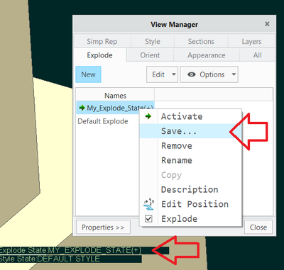

Hello, I wanted to see if anyone else has dealt with this issue before. The exploded-lines that I create for my exploded drawing views are constantly disappearing or should I say, getting deleted. I have no clue why this is happening. I'm very meticulous with saving my views along with my drawing files too. Yet often when I close the file and open it back up again, the lines are gone and nowhere to be found in the model tree. This is beyond frustrating. I just wanted to ask if anyone else has these issues too.

Are you certain that you are saving the explode states when you create/modify them? Saving the view will not save the explode state.

When I create and/or modify my exploded views, I always save that specific view within the Exploded section of View Manager. I'm not sure of any other way to save the exploded view. I've also checked the layering just in case it was affecting the view but I didn't find anything related.

Not sure how you are doing it, but: if you have that (+) sign after the name of your exploded state... well, just know that means there are changes to it that will NOT be saved to disk upon file-save.
After editing the exploded state, the next step is typically:
I wonder how many people-years have been collectively wasted in meticulous preparation of exploded views, only to forget this vital step.  I know there are several hours of my life I will never get back 😅

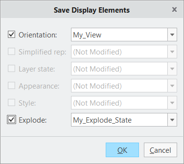

But you mention that you save the view; when doing so, are you getting a dialog box like this? :
That should make that (+) disappear, so then I'm not sure why your explode lines would be disappearing.

Yes, I do get the "+" sign when I make changes to the exploded view as you've shown. I do make sure the "+" disappears when saving the view, although I've been guilty of not doing this also. I just recreated the exploded lines again, so I'll keep an eye out for the next time it happens.

Prior to Wildfire 3 when you made an explode it was automatically saved. When PTC introduced combo states they added a step where you needed to manually save the explode. I created an idea for an auto save but it was archived due to not enough votes:
