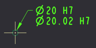

We need to make a single plane for both the finished dimensions and the machining dimensions, before surface treatment. How can we automatically add a machining value to a dimension? The idea would be to display both the finished dimension and the machining dimension.

you can create note attached to geometry and put two dimension callouts into it.

Thank you but it is only valid for the holes? Another solution for the other functions?
you can create such note for any kind of dimension.

And how can I do it automatically for each function?
you have to do it manually.
