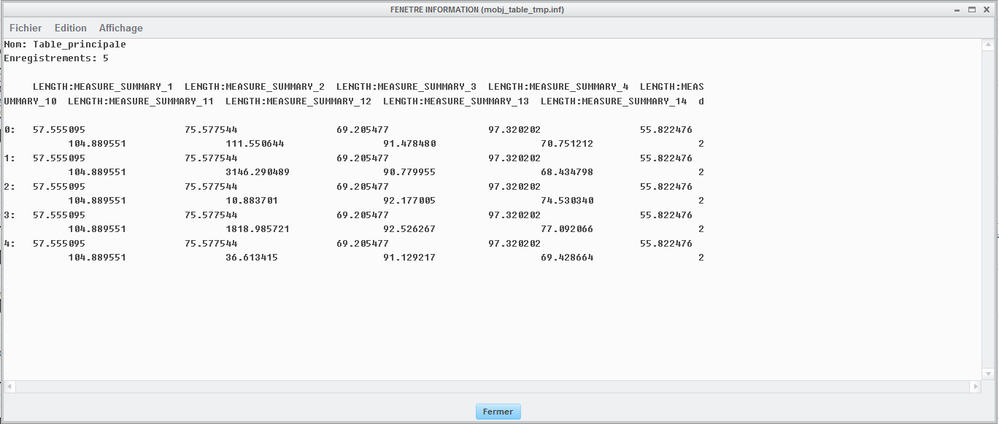

I would like to know if it is possible to modify the display of information windows in Creo 2.0?
For example, for feasibility studies with many parameters, the results are displayed on several lines (So are difficult to exploit) :
Thank you

These are saved on disk and can be read into a spreadsheet for reformatting them.
There is no option that I know of to change the format from within Creo.
Yes but for a table with many lines, it is long to reformat !
