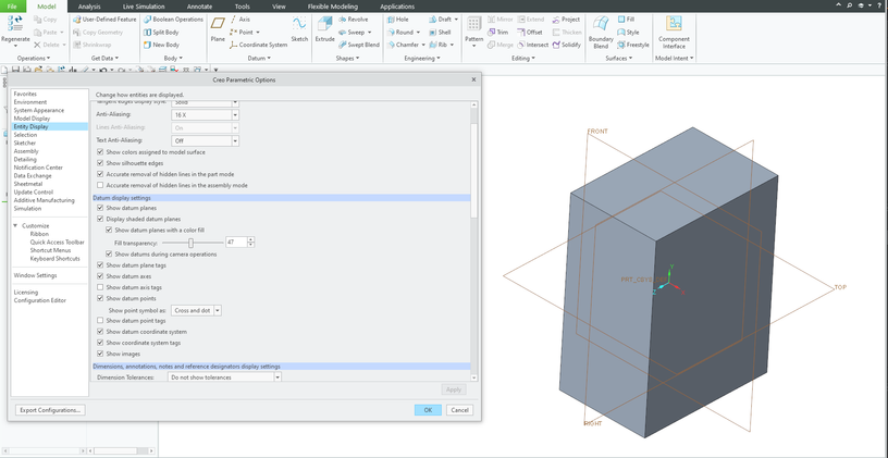

I just installed Creo 8.0.2. I have  "Display shaded datum plane"  selected and the config.pro option  "3D_datum_display_fill"  set to yes, but my datums aren't shaded. Anyone have any idea what I'm missing?

But that's a different issue from mine. My problem is that I can't get the datums to shade at all. As you can see in the image, I have selected the datums to be shaded, as explained in Help Center, but they will not shade.
please let us know what values are set for following config.pro options
3D_datum_planes_transparency
spin_with_3d_datum_planes
enable_legacy_datum_planes
I guess that enable_legacy_datum_planes is set to yes.
Martin Hanák
Also, you can rename all config.pro files to hide them for Creo, start Creo and create new part to see datum plane display. If filled datum planes are displayed then your problem is caused by config.pro option.
Martin Hanák
That's it, thanks. The datums are shaded with an empty config.pro file.
I had 3D_datum_display_fill set to yes, 3D_datum_planes_transparencypercent set at 47%, spin_with_3d_datum_planes set to yes, and enable_legacy_datum_planes set to no. Something else in there is causing the problem.
Along with the new options they come up with for each new release, I wish PTC would also tell you which ones need to be deleted.
For the record and in addition to Martin's excellent solution, the config.pro option that was preventing the datums from being shaded was enable_opengl_shader. I deleted it from the file, and now everything is running smoothly.

Now I see another problem. Some of the components in my assembly are completely hidden by the datum planes. When I hide the planes then I can see them. This occurs with the default empty config.pro file.
I'm beginning to think shaded datum planes aren't quite ready for prime time yet.
Is this a situation where no config.pro file means 0% transparency? Did you try to change the 3D_datum_planes_transparencypercent value to see if it behaves better?

If you have the config option blended_transparency set to YES or No, it will block components in your assembly.  Setting this config option to independent * which is the default setting will fix this issue, at least it did for me.

That's a winner. Solved! Mine was set to YES for some long-since forgotten reason.
