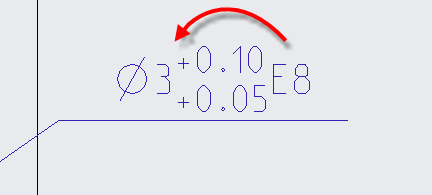

I am still using Creo 4.0 M050.
When making 2D drawings of a part, I usually specify a dimension tolerance as 'Plus-Minus' or as a 'Letter-Number' combination (like H6, G7, E8 ...).
Sometimes I feel it is more appropriate to specify both.
The nuisance is that Creo puts the Letter-Number combination (E8 in this case) always behind the Plus-Minus numbers.
So, like this:
But I would prefer that the E8 comes immediately behind the nominal dimension, and in front of the Plus-Minus. Like Diam 3E8 +0.05/+0.10.
I couldn't find a way. Is this possible in Creo 4.0 ?

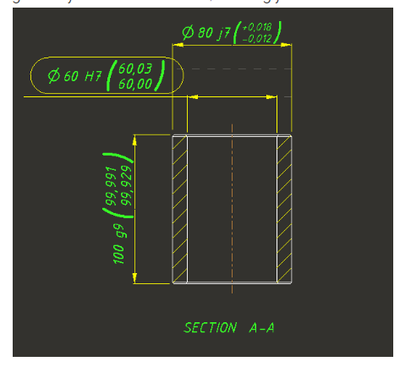

Try the detailing settings discussed in thread ISO Standard Fits and Tolerances - where the dimensions show up more like what you want:

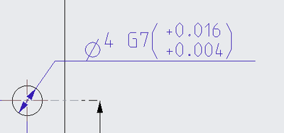

The method as described in your link, works for me in Creo 4.0 .
Thank you so much!
