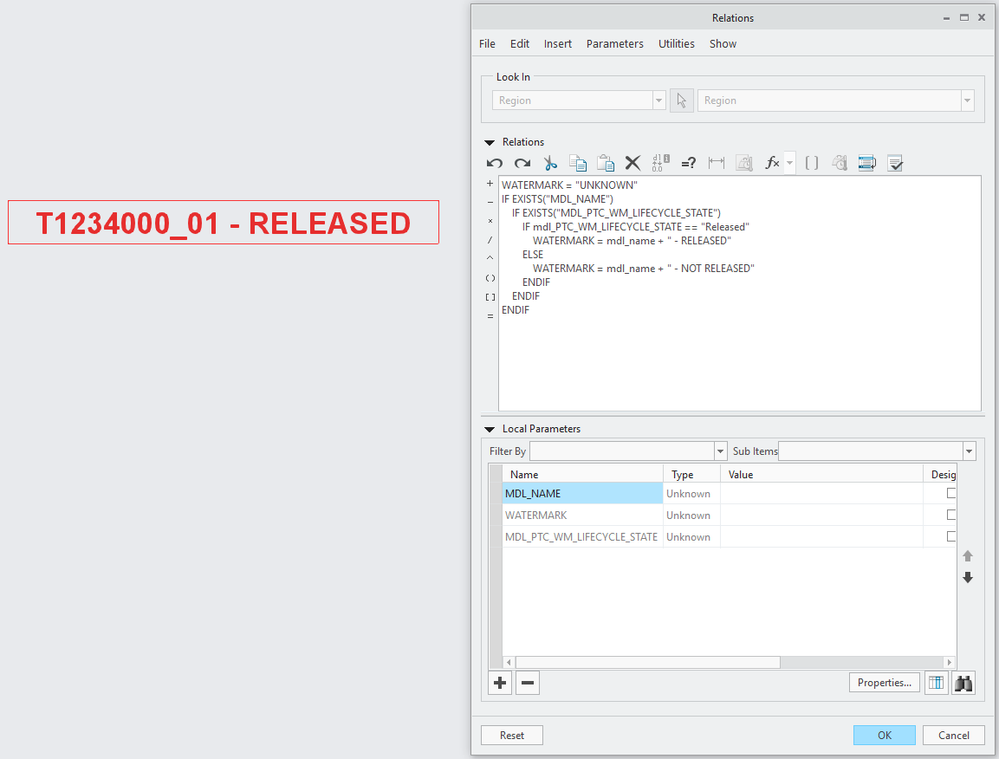

TomU
(To:TomU)
Okay, one more idea.  If you're okay with using model parameters to drive the information displayed on the drawing, AND you're using Creo 5 or later, you can create a single cell repeat region that has it's contents based on the model's name and something else (like lifecycle state).  Not quite the same as a symbol, but might still accomplish what you need:  (You could also show or hide this based on the lifecycle state of the model in the drawing program.)  For example:
