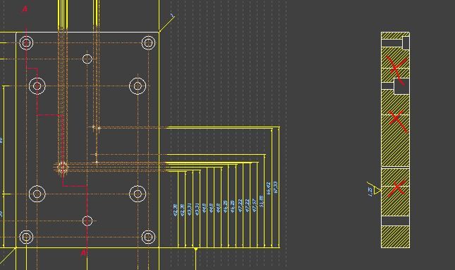

Hi. I make a section in my part and i want show in drawing. But creo showing a cut line in section view. Is there an option to disable their display?

This is controlled by the drawing detail option show_offset_section_seams.
File>Prepare>Drawing Properties>Detail Options
Thank you for your help.
