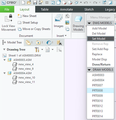

Can someone please help me with drawings. Im trying to add 4 different part models to a drawing. When I try to label them with &model_name they all keep the name thats preselected on the bottom of the drawing(I attached image). Can someone please help me fix this issue?
1 REPLY 1
You need to activate the model that you are trying to label first.
or double click on name at bottom of screen and select.
or RMB on view and select Use Model in Tree
