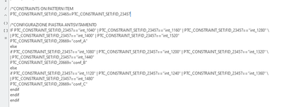

I've done a relation for chose the constraint set of a component in an assembly.
The relation works well with the component.

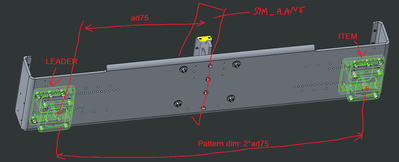

The component constrained is the leader of a pattern of two items.
When I change the leader constraint, the other item should modify his position simmetrically w.r.t. a central plane, so I've done a direction pattern with the dimension twice the annotation distance between the component and the plane of simmetry.
When I chose the leader constrain, I have to edit the pattern feature to regenerate the position of the other item: how can I update the simmetrical position of the other item without edit the feature pattern?

Hi Michele,
You can try regenerating a second time.  Creo and previous releases have historically occasionally required a second regeneration to update certain relation objects.
If that does not do it, you can also force the regeneration via:
  1. dragging the insert mode to the top then back to the bottom
  2. use the Tools > Model Player to roll back the model and completely regenerate
