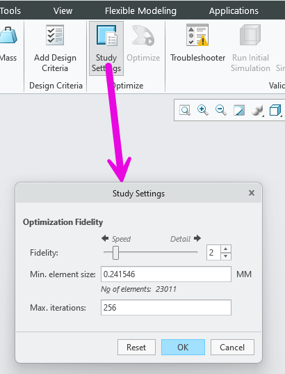

In the Generative design module, you can specify the minimum element size.

I already adjusted many influencing factors such as the fidelity level, optimization goal etc. and evaluated their effect on the results. As my next step, I want to import the generated, reconstructed designs into an external FEM software and compare the analysis results of Creo Parametric and the FEM software. Therefore, it would be very helpful to be able to compare the element types between the software additionally to the settings that Creo GD offers.
