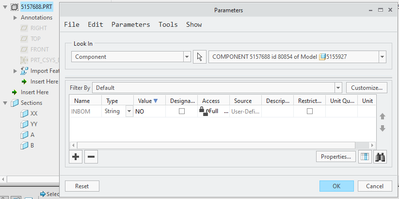

pausob
(To:BrettL.)
I don't think this is an out-of-the box functionality.
and so I think you have to develop a business rule and have the members of your organization follow it.
Tell your engineers to add a component level parameter to the included components and then filter out based on the value of that parameter.
For example:
The engineer assigns a string-type parameter "INBOM" and sets it to "NO" for those assembly components that should not be in the drawing BOM.
Then in the drawing, the filter is added to the repeat region table:
&asm.mbr.cparam.INBOM != NO
