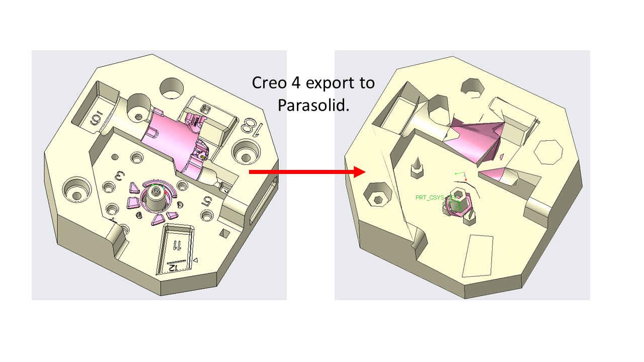

Having real issues with the the export of parasolids in creo4. When reading back in they are really chunky,with surfaces missing. Anyone got any tips. Parts are set to default tolerance in mmns.

Customer data in....(Pump body model. Solid works ...step file)...Read into Creo4.
Model pack constructed.......
18 mold parts cut from parent body model to produce tool files for sand sintering.
Sand sintering company wanted parasolid opposed to stl files....for some unknown reason.
Exported parasolid....the rest you can see..

(To:Genero)
Cool... so you are reading the files in fine from the customer (STEP is pretty reliable out of SW)...
You do your thing...  and export out individual part as parasolid (X_T) [binary or ascii?]...
And upon checking those parts by re-importing them in Creo 4, you find the clunky models.
Is this correct so far?

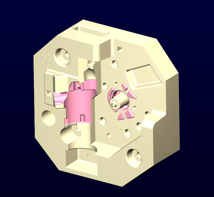

Genero
(To:TomD.inPDX)
Hi
See attached base mold ( drag ) part of the pack.
Cheers
Steve
TomD.inPDX
(To:Genero)
There is something wrong with your install.  I'm pretty sure you have a config or template hung somewhere.
In Creo 2, my default configuration, I get this:  confirmed with Creo 3 generic
Genero
(To:TomD.inPDX)
Hi.
Wow.....that was on default config. That's what it should look like....
Any ideas what config setting could be different in the creo 4 config....
