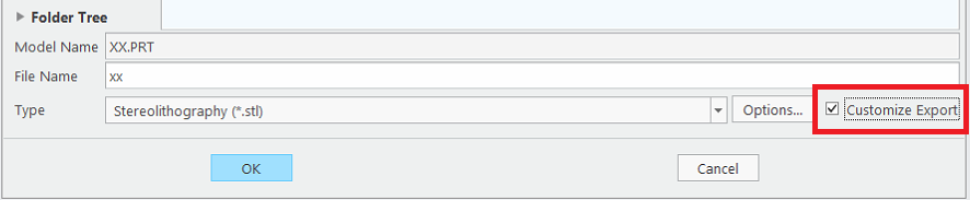

Does anyone know what happened to the STL export dialogue box?  It used to offer the ability to modify the Chord Height (etc.) before creating the file.  Is that not an option anymore?

you have to check Customize Export option before clicking OK.

That did the trick, although I was sure I tried that yesterday.
You may like Config option Intf3d_out_configure_export as Yes
This also works.
I would mark it as the correct answer if I could flag 2 solutions.
Maybe it will someone else someday.
Awesome! Thank you!
WHAT!? Are you kidding me!? What kind of absurdity is it to remove a function, hide a function that people, users, customers count on to be there???? What was the thinking behind the decision to HIDE the  @#$% window behind a tiny little check mark in the corner of another window? And I have to check it EVERY TIME I WANT TO SAVE A .STL!? Come on PTC. This kind of non-thinking is part of the reason we're moving to SolidWorks.
Take note of the config option above.  Makes the customize box default to checked.
