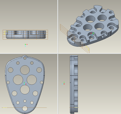

I have a part model that is solid geometry. When exporting the part using STEP it generates the file but the STEP file does not contain any geometry when imported.
The part does not have any geometry checks and has absolute accuracy (1E-4 inches) set in Creo 7.07. The geometry is not what I would call complex.
I have been able to get around this issue by saving the part as a Creo neutral file, opening it as a part and then exporting it as STEP. This process yields accurate geometry in the STEP export.
The source part file will not export to STL either but there is no diagnostic info on bad geometry. Typically this would identify are where tessellation failed.
Has anyone else encountered this issue?

Creo opens empty when opening the STEP export of the above part. It is surprising indeed as the geometry is mainly prismatic.
Can you clarify the below:
  1. what protocol do you export to?
  2. is the STEP file of size 0 ko?
  3. what does the content look like when you edit the step file with notepad?
  4. by change have you ever tried STEP Analyzer? STEP File Analyzer and Viewer | NIST it is an agnostic STEP tool used as a controling tool.
  5. when importing the STEP file, do you include a template? if yes have you tried without it?

The part file is native Creo geometry created in Creo 7, it does use a copy geom driven by an external reference.
The Creo part reports accurate mass when measured in part mode.
I have tried the following STEP protocols exporting solid geometry only.
ap203 is
ap214
ap242
STEP file sizes are not=0 but are small i.e. 14Kb & 250 lines
Warning message upon opening STEP file in Creo as a part:
Could not construct feature geometry.

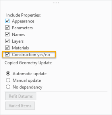

Please note that the ECG has settings within its option panel to control the propagation of parameters.
This includes several aspects ranging from appearances to body names and more, and it also includes an option to propagate the construction body attribute. It also depends on whether an external body/or bodies are added "as is" or being merged into the existing body in the part.
Here is how the options look like:
Hope that helps

Is the setting Construction yes/no a logical  toggle when redefining the ECG feature in the target part? I tried editing the definition of the ECG and unselecting the Construction yes/no. When I regenerate the body is still a construction body. I must be missing something and I cannot find details of this in the on line help files.

yes, it is a logical toggle that allows to control whether the status/attribute from the source should be propagated to the target.
If you "uncheck" it, the "construction" body attribute/status will no longer be propagated to the target. That means an update of the ECG will no longer force an update of the construction attribute in the target body. In your case, I assume that means the target body will stay a construction body (simply because that is its current state  and no update is forcing the body to change that status.) If you do a right-menu action on the body to "Unset construction body" status, then the body should become a regular solid body and should no longer change to construction during an ECG update.

Thanks for clarifying this, it resolved the issue for me.
I was able to activate the toggle option in the ECG and then manually unset as construction on the body to establish the design intent for the part as desired. Unless I missed something in the on line documentation, I think more detail should be provided for this in the help files. There are some nuances of multibody that most users will never figure out without some more explicit documentation.
