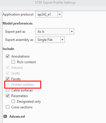

I have a similar problem, but with parts. The stepfile includes many surfaces that are hidden in the part, and should not be exported.
However, the option to exclude these hidden surfaces is greyed out:
How can I exclude these hidden surfaces from my STEP-export?

Looking at your settings I found that selecting Annotations is what is greying out Hidden entities.  If you don't need to export the annotations, deselect Annotations.
I don't know the thought behind this limitation.  Maybe because annotations are typically hidden on a layer.
andrehj
(To:kdirth)
Thanks! The annotations were the problem indeed.
I agree with you, no idea why PTC made this choice. In our case we do want to have the annotations (geometric tolerances etc) in the STP file, but we do not want the hidden features....
For this specific case leaving the annotations out was acceptable.
You can Enable the Annotations and Disable the Hidden Entities by using an export profile.
Then edit the .dep_step profile file and set the Hidden Enitites to zero:
            <profile_options_xar__ENTRY id_="Hidden entities" pointer="TRUE">
                <value___PO__b__PC__>0</value___PO__b__PC__>
