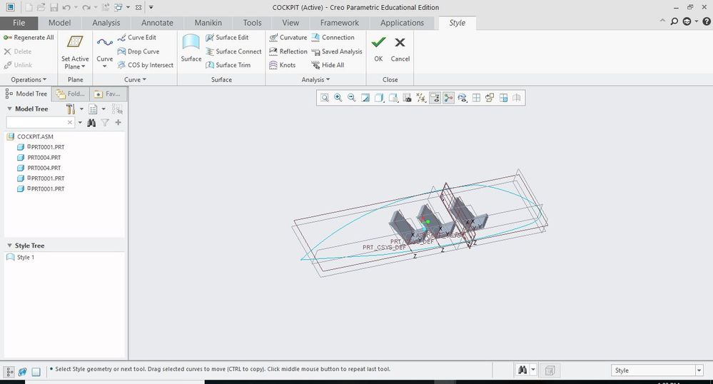

Hello everyone,
I am trying to figure out how to take my side view of my fuselage and make it into an extrude with circular sides. I have tried all of the blends but I'm new to creo and I don't know what to do. I just want it to look like an egg, basically.creo question.JPG

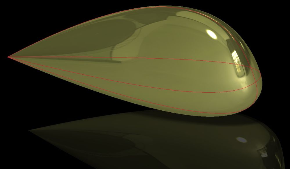

Are those green lines curves used to control the boundary blend?  If so, you can see the ripple follows the curve.  If so, get rid of the extra curves.  The only curves I used are highlighted in red in my pic.  too many curves cause the ripples, you only need 3 total for each quilt.  Left, top, and right used for the top quilt, and I made sure the boundary edge conditions were normal to the top datum plane.  For the bottom surf, similar, but I used the edges of the top surf instead of the L and R curves, and used curvature continuous (to the top quilt) for the edge conditions, then I merged it.

Based on those 2 curves, it will never have anything "circular".  It will need to be a boundary blend.  I did it in 6 features.  When you do a BB, you have to be careful what order you pick what curves in.  I did the top half, set boundary conditions, then did the bottom half, set different boundary conditions, then merged them.  Very smooth, if not exactly C2, surfaces.

I actually ended up using 4 longitudinal curves, top, left and right mirrored images of each other, and a bottom curve.  I made the top half, then the bottom half and even though the shape was totally non-symmetrical from top to bottom and the curves were all pretty different from each other, it came out really smooth (almost C2).
I find that using a bunch of different sections leads to ripples, best to use as few curves as possible, that's why I'd recommend using longitudinal curves.

Query-select and use the entire curve, from the rounded front to the pointed back on the left curve, the top curve, and the right curve, then set the boundary conditions on the edges to be normal to the datum.  Then make the bottom quilt in similar fashion, but set the boundary curves to curvature (to the upper quilt), or if it won't take that, to tangent.  Not sure why your pic shows the quilt not exactly following your top curve.
For the curves, you could use a spline, or as I did a conic, or just query-select and get the chain of curves.  The "details" tab will allow you to pick all different things.  But to add a second or additional curve you must do an "add".
Edit:  I get now why it isn't following the curve exactly.  Depending on the shape, you do not need second direction curves.  Just use 3 longitudinal curves, making sure they give you the shape you need at the points you want (i.e. might make those points in the splines used as the curves).  But, as I said, beware, too many control points of any sort can/will cause ripples.  Best to give it as few as possible for a smoother result.

It's not that you're using ellipses, it's that you're using the ENTIRE ellipse, and in the wrong direction.
In my picture I highlighted in red the curves I used for the Golden Teardrop.  Note how non-symmetrical top-to-bottom the shape is, and how different the top and bottom curves are from each other, and from the mirrored left and right curves.  I used conics, tangent at the front, as they typically give great surfaces.

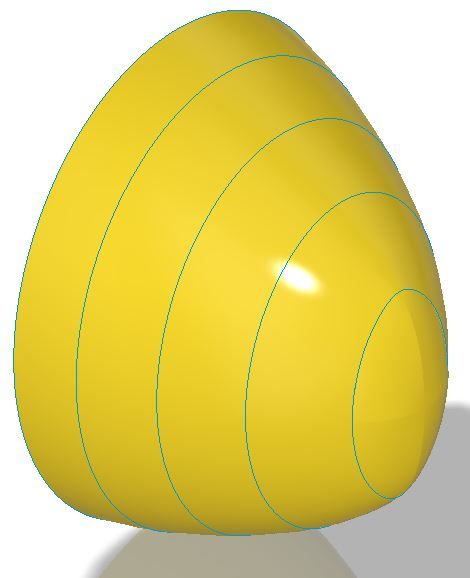

This is my best effort (creo file attached for you to analyse) ... it's only experimental and somewhat hacked together.
Creo nose cone (of sorts), using blended elliptical sections and boundary blend.Creo nose cone (of sorts), using blended elliptical sections and boundary blend.

Quick and dirty.The Golden teardrop......The Golden teardrop......
