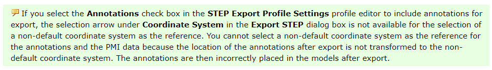

As usual, when they revised the GUI (Bold New Graphics!), they completely FUBAR'd things.  I'm simply trying to export a STEP file and NEED to pick a specific CS....aaaaand I can't.  This interface $uck$!  For some reason the ability to pick a CS is greyed out.  What?????  This is something we NEED to do often.  Is there an "optional" module I need or something?  I'm p!$$ed.

You need to remove annotation elements from the export, then you can pick an alternate coordinate system.
https://support.ptc.com/help/archive/creo40/creo_pma/usascii/index.html#page/data_exchange%2Finterface%2FExporting_Part_or_Assembly_to_STEP.html%23

Thanks Tom!
*facepalm*  Some "enhancement"...  For some reason exporting the annotations is our default...
