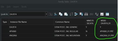

This is the PartFT_generic - Family Table definition:
PartFT_generic - FT definitionPartFT_generic - FT definition
Generic: DAJ974_01.PRT
Instance1: 4PV880_01.PRT
Instance2: 4NQ966_01.PRT
This is the AssyFT_generic - Family Table Definition:
AssyFT_generic - FT definitionAssyFT_generic - FT definition
AssyFT_generic: DAJ974.ASM
AssyFT_instance1: 4PV880.ASM
AssyFT_instance2: 4NQ966.ASM

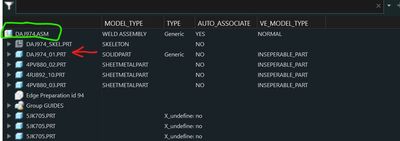

This is the model tree of AssyFT_generic:
AssyFT_generic - Model treeAssyFT_generic - Model tree
Generic name: DAJ974.ASM
loaded PartFT file: DAJ974_01.PRT (the PartFT_generic)
Intended file: DAJ974_01.PRT (so the correct one is loaded)

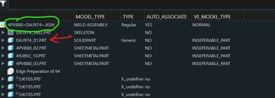

Here you see the model tree of AssyFT_instance1:
AssyFT_instance1 - Model treeAssyFT_instance1 - Model tree
Instance name: 4PV880.ASM (AssyFT_instance1)
loaded PartFT file: DAJ974_01.PRT (this is the PartFT_generic)
Intended file: 4PV880_01.PRT (so the INcorrect one is loaded... PartFT_instance1 SHOULD have been loaded....)

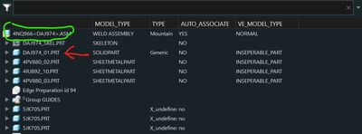

And finally, here you see the model tree of AssyFT_instance2:
AssyFT_instance2 - Model treeAssyFT_instance2 - Model tree
Instance name: 4NQ966.ASM (AssyFT_instance2)
Intended file: 4NQ966_01.PRT (so the INcorrect one is loaded... PartFT_instance2 SHOULD have been loaded....)

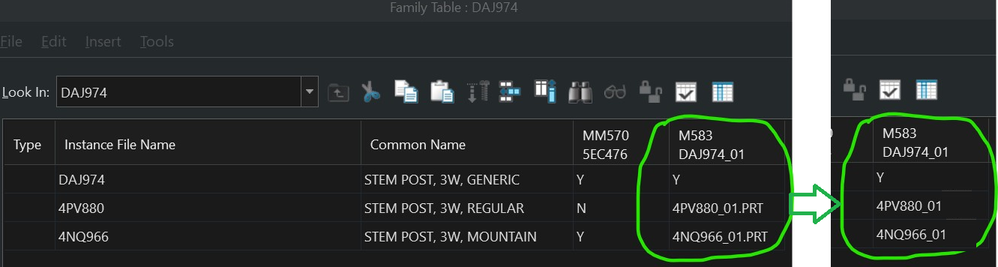

I have both manually entered the instances using "INSTANCE1.PRT" and "INSTANCE1" which both did not present error at the moment of entering it in the Family Table menu. Entering "INSTANCE1<GENERIC>.PRT" (as it shows in the Model tree) is not allowed at all (tried that after being asked to in a former answer on my post).
I did the FT cell input through the menu option "TOOLS > REPLACE USING > FAMILY MEMBER .,," which makes the Family Tree menu pop up and lets you choose the instance you want to use. Creo fills in the cell itself (and does it in the format "INSTANCE1")

Yes.. closed all files, purged memory and reopened. No solution. Closed Creo, restarted Creo, reopened the files, no solution. Even closed the computer, restarted it.. no result
ok MV,
I would try another thing, remove the extensions in this family table and then 'Verify instances of the family'...
MV_10003361
(To:Trebla)
Hi there Trebla!
Did that (for the third time already 🙂 ) and still no result.....
