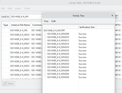

just a basic question: Are all FT instances successfully verified and then the generic model saved?
Martin Hanák
Mat
(To:MartinHanak)
Yes, they look all verified:
