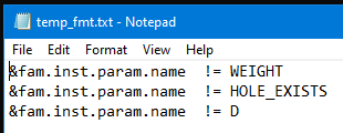

1.] I added parameters DD, HOLE_EXISTS
2.] I modified FT
3.] I modified relations
4.] I verified FT and saved the model
drw
1.] I modified repeat region filters
2.] resulting drawing table
I uploaded modified files.

@KSHITISH_S wrote:
I have attached the drawing and part
I modified prt+drw in Creo 7.0.5.0.
prt
2.] I modified FT
drw
Martin Hanák
Hello @MartinHanak , Thanks for the solution. Its a work around but can work for me.
