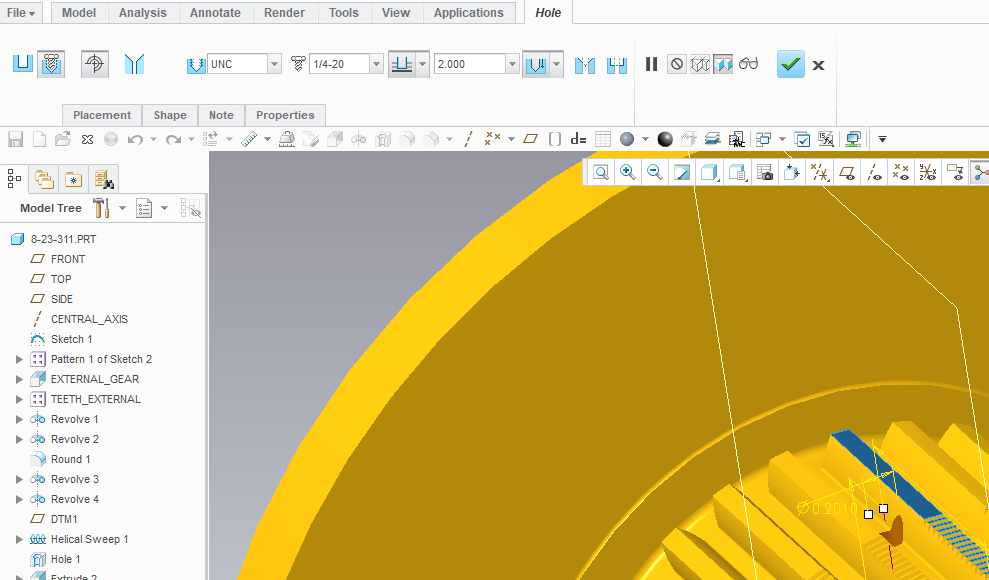

Is it possible to vary a tapped hole size in a family table?
I have a family table of a hub where the key size varies by F.T. instance.  A tapped hole for a set screw over the key also varies based on key size.
If I define a standard tapped hole, is it possible to change the thread in the family table?  (i.e. if the Generic has a 1/4-20 thread, can I have an instance with a 3/8-16 thread?)

Yes, but it adds complexity to the table.
You need to have all of the tapped holes added to the generic and then add the features to the table and turn them on and off depending on which size you want in that generic.
Probably could do a more automated method with Pro/Program, too.

Pretty much as was said in the previous answer.
Hole tables are not the same as family tables, though you would think that they should be. Therefore it isn't possible to swap out like features and components do in FT.  If you have 2 hole options then you need to model the two hole sizes in as 2 features and suppress the one that you don't want in the family table of the part. Make sure that you don't use the reference for the first hole as that for the second or they will both disappear when you suppress the first one.
Hope this helps.

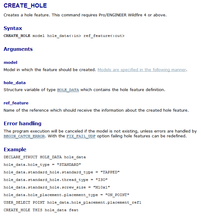

@ptc-2790516 wrote:
Is SmartAssembly for automating components in assemblies or does the scripting language contain functions for manipulating features from parameter values at the part level?
Yes.  SmartAssembly is fully capable of manipulating both parts and assemblies (and drawings).  It can create new hole features and switch existing hole features to different sizes and series.  It is also capable of manipulating any of the hole feature's dimensions or notes after placement.
For example, the CREATE_HOLE command:

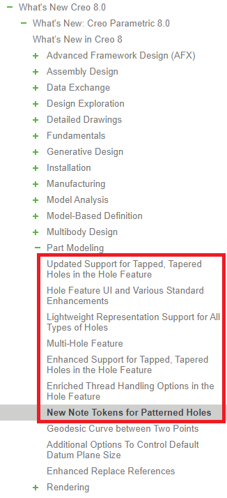

Quite a bit of work was done in Creo 8 related to hole features.  One of these was the addition of some new hole note tokens.  While the default, out-of-the-box notes are still are not ASME compliant, with these new tokens it is now possible to automatically create hole notes (from a .hole file) that are fully ASME compliant.  🙂
https://support.ptc.com/help/creo/creo_pma/r8.0/usascii/#page/whats_new_pma%2Fcore-new_note_tokens_patterned_holes.html%23
