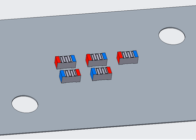

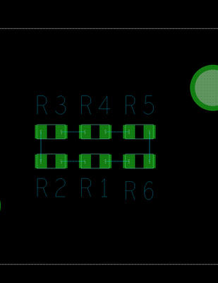

Below is a sample test board assembly in Allegro Cadence R6 is the new copied 2D that is not in CREO library

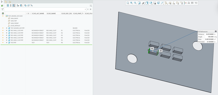

When imported the files into CREO.  It warned that the geometry is missing. CREO gave option to try to sketch build or not.  We tried both options.
What came up was this.  (See below. )  R6,the copied 2D RES geometry,is missing but had no message coming up missing.  We had to dig into ecad log file to see there was a problem.   We’re seeing cases where there are 2D being created no problem, but a few 2D are not being created.  Has anyone else experience this issue?

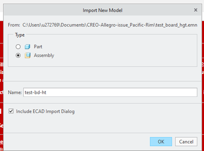

Then I tried to import the emn file using options
  • On the "Import New Dialog" select assembly and check the "Include ECAD Import Dialog" option.
  • From the "ECAD Input" dialog remove Check Mark from "Use Default Template"
  • On template selection dialog I selected a template named "ecad". This template was available on our server. I do not know where this is from...
End result looked OK. I guess this is how it should look...

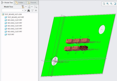

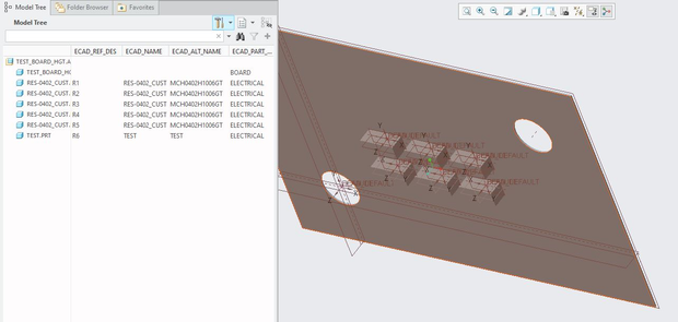

We actually have creo 4.0 M070 on our old machines so I tried to read your sample files test_board_hgt.emn and the test_board_hgt.emp with that...
Surprisingly I did not have any issues reading the sample board. Both the default template worked (added some colors)...
And the ecad.prt template worked OK (I added the colums ecad_ref_des, ecad_name, ecad_alt_name)...
In my opinion the imports worked better on 4.0. I did have some issues with the 9.0 default template.
attached is the 4.0 M070 ecad template that is used on the above import...

Lars_F
(To:SS_10724812)
No, I don't get any messages about fixing geometry in 4.0 (I got those messages when I imported the design with 9.0).
And yes, I opened the design from the beginning
  • file open -> *.emn
  • import type -> assembly (I don't need the checkmark to include ECAD import dialog on Creo 4.0, but it worked fine with the ecad.prt template also)
  • then the import asks where the test_board_hgt.emp file is
After the import creo informs that
"Import succeeded with warnings (see ecad.log)"
The log file looks like...

Lars_F
(To:Lars_F)

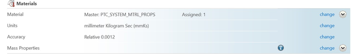

As I mentioned previously in creo 9 the import doesn't work with our default template but the import works with the ecad template. However in creo 4 the import works with both templates.
One thing we changed when we switched to  9.0 was that we changed the default template accuracy to "absolute". I then checked what is the ecad template accuracy in 9.0... and it was still "relative". So I think that is at least part of the reason why the .emn import worked only with the ecad template in 9.0 but worked ok for both templates in 4.0...
our default template...
Our ecad template
br,
Lars
