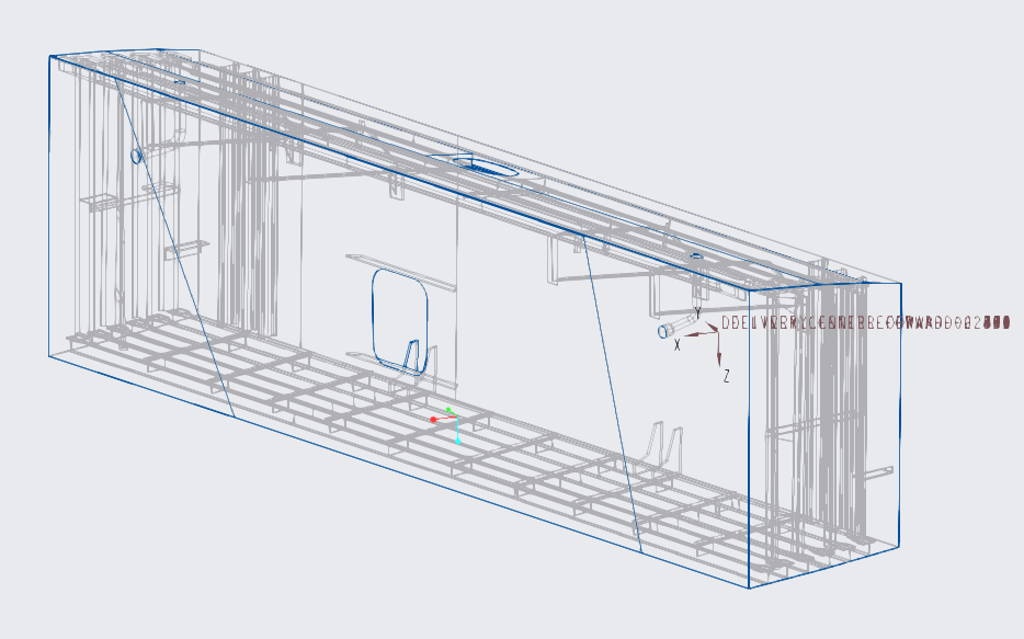

Hello everyone,
I need to find the geometry that fill a complex solid (see image below).Capture.PNG
Anyone knows which is the propper methodology?
Thank you.
1 REPLY 1
tbraxton
(To:victorNaez)
Copy the surfaces of the inside wall of the solid. Fill holes as required to close the quilt. Using the seed/bound selection can greatly speed up selection of the surfaces.
Once you have a closed quilt you can solidify it. If you have other solids that would subtract from this envelope then use the merge/cut out functionality to remove those elements.
