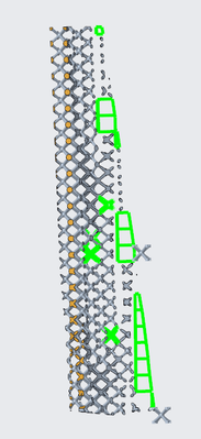

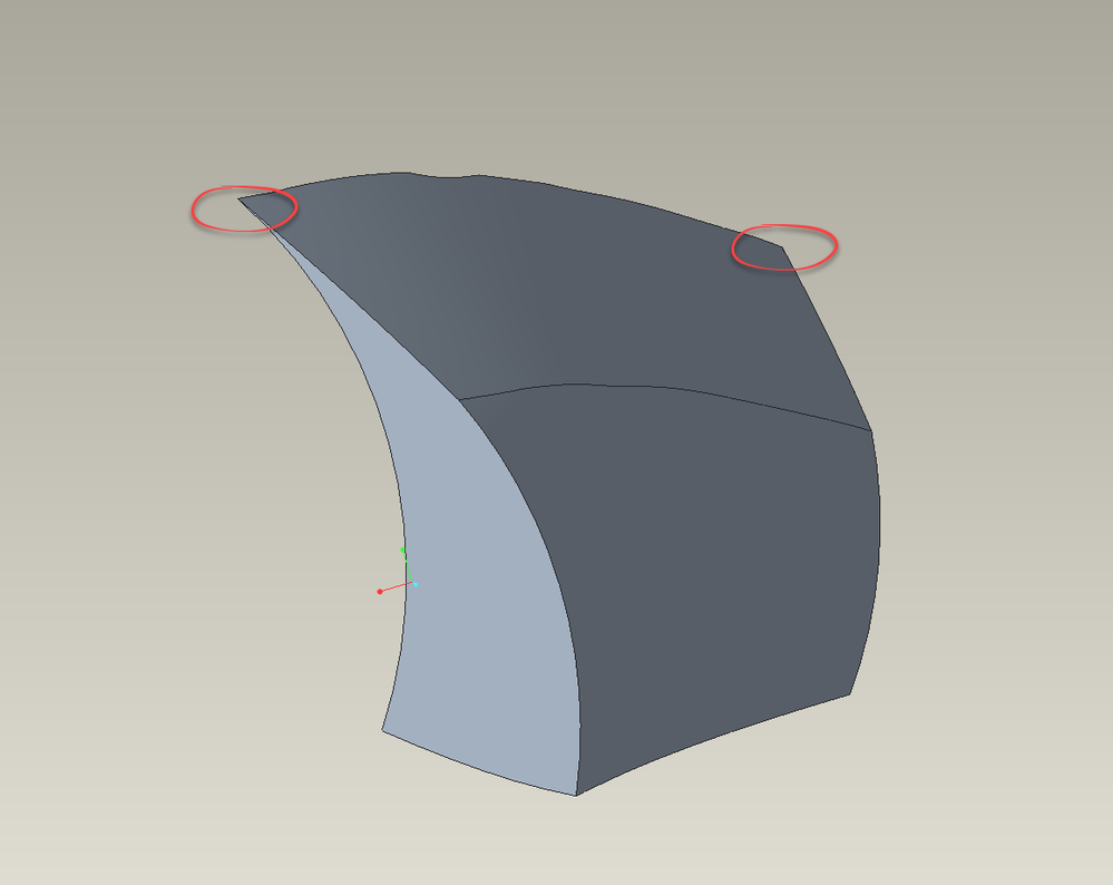

I frequently encounter the following problem and I can't wrap my head around it. I'd appreciate if some of you experts would like to shed some light into the situation.
I am trying to fill a portion of a component with lattice structures. I have separated the part to be filled as a separate component (you can find the part attached to this post as .prt, .igs, .stp). I am using Creo Parametric 9.0, and it only allows me to fill the part with formula-based lattices. When I try to fill it with beam lattices (e.g., hexagonal, see screenshot), I get a feature error. I also attempted to cut the body from a lattice cube using a Boolean operation, but without success. I tried this with many similar bodys, and can not get it to work properly.
Does anyone have a suggestion as to why this is not working?
My lattice Options:
Option for hexagonal beam latticeOption for hexagonal beam lattice

This knife edge geometry is likely a problem. Try shelling out your model and then apply the lattice following the method that @Dale_Rosema posted.

Thank you for your input. The Knife edge is crucial in this design and can not be avoided. I have, however, tried  the above mentioned method on a similar geometry that does not contain a knife edge without success. I assume this is the limits of the complex calculation required behind creating these lattices.

I do not have a lot of experience with lattice structures, but could you initially stop short of the knife edge and after adding the lattices, add the knife edge back to the part? Just a suggestion.
Thank you for your suggestion. The knife edge comes from a sweep, so I don't see a way to add it in later on. The knife edge sure is problematic, but it does not seem to be the main culprit here, as I can not perform the same action even on a similar body without the knife edge.

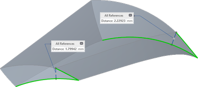

Hi @Garbean
@tbraxton  drew your attention to the fact that you have knife-edge geometry, and you are drawing a (wrong) conclusion about Creo's capabilities.
Notice that you're attempting to fit a 3x3x3 mm grid into a space that can only hold 1.8-2.2 mm.
Furthermore, I don't understand why the lattice is required to reach the blade's tip rather than remaining a solid that maintains the entire geometry. Even assuming this is the design intent, I'm not sure how you'd print such a part with such a thick lattice, let alone the issues that would arise from adding the ball at the cell nodes. Judging by the geometry, this appears to be an academic activity.

Thank you for your response. You are correct in pointing out the knife-edge and the limited space for Creo to build the unit cells. I understand that this is not an easy task. However, it is not a problem for Creo Parametrics to construct formula-based unit cells within this constrained space.
I experimented with several different geometries that have less pronounced edges, but I still could not get it to work. I do not believe I am drawing the wrong conclusion here. In my opinion, the software should be able to cut out any portion of a lattice, no matter how thin. As I mentioned, I also attempted to cut it out of a block consisting of unit cells using a Boolean operation, but I encountered the same issue.
The above part will be integrated into another component and will be fully printable, even if only fractions of the unit cell occupy the space.
