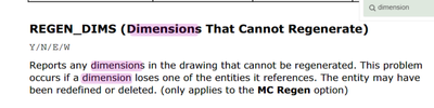

pausob
(To:Trebla)
Apparently modelcheck can find them:
I am not an expert at modelcheck so I can't help further.
AFAIK, the search tool cannot find these "unattached" dimensions (the kind that were created in the drawing and had their references destroyed during modeling)

pausob
(To:MartinHanak)
very clever.  one of the best pro-work-arounds i've seen.
also works way better than the model-check, which when I looked into it, seems to only tell you that such dimensions exist (and does not tell you what and where they are)
