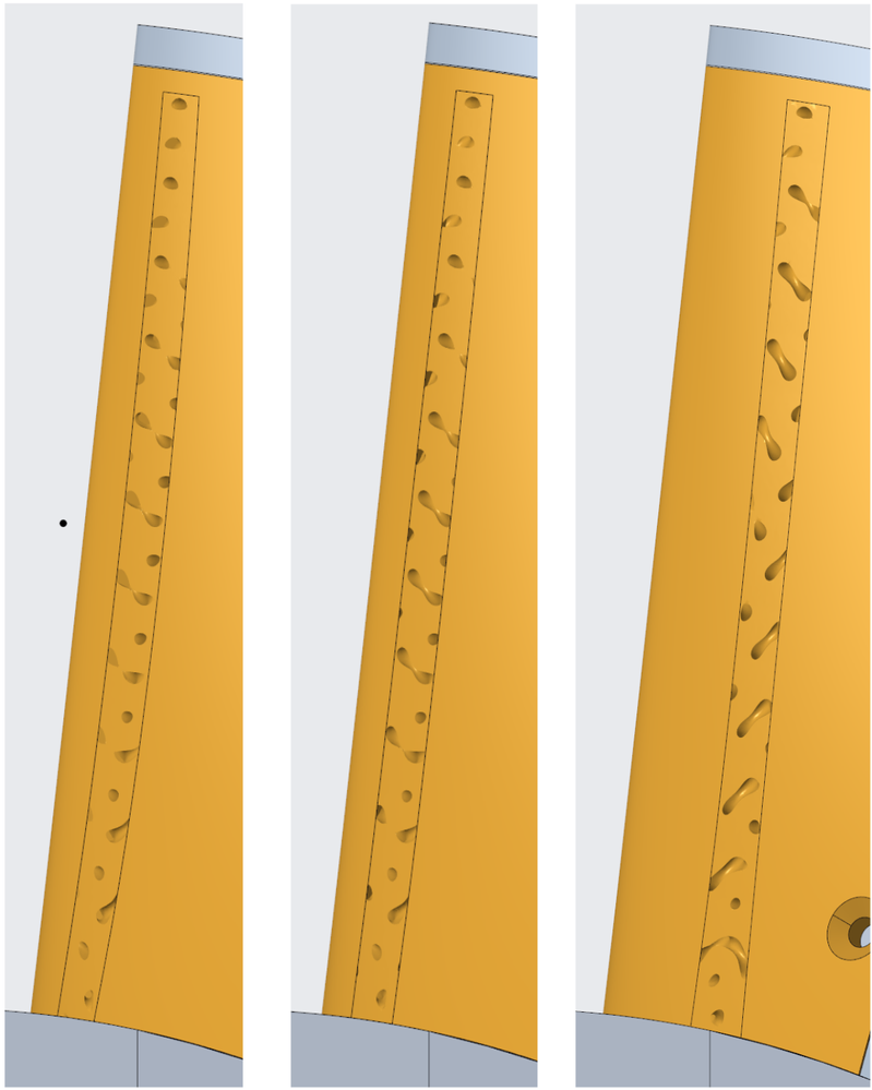

I want to replace a section of a part with formula driven lattices (Gyroid in the example case).
I also want to try out different shapes for the section to be replaced and have the same surface for each version.
In the three examples below, the shape and position of the section to be replaced is slightly different.
Different versions of slots going trough the partDifferent versions of slots going trough the part

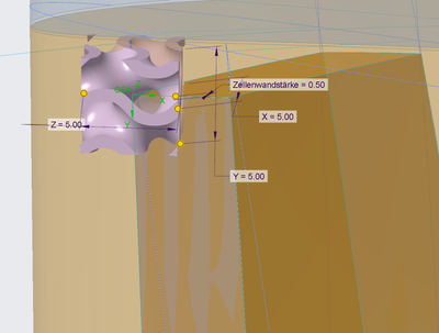

For each case, I am placing the first unit cell in the top left corner and orient it along the slot as shown here:
Unit Cell orientation and placementUnit Cell orientation and placement
I understand that as the Part is wound in space and does not consist of a straight surface, the unit cell gets "cut" in a different way depending on the position of the part to be replaced on the surface.
Is there is a way to get the same surface for all three different positions? To have the unit cell align itself on a curved surface so to say.

Yes, certainly! Sorry for taking so long. Please find attached the three different bodies side by side that I want to replace with the same lattice structure in an .asm file with the three parts as .prt.
My wish would be, to orient the lattices in such a way, that SURFACE1, SURFACE2 and SURFACE3 turn out the same, even though their geometries vary. I am unsure weather this is an impossible ask. I want the lattice to be oriented along to surface so to say.

I just checked, and Flatten-Quilt Deformation does not work with Formula-driven lattices.
Do you have to use formula-driven lattices?
Hi ProFeature,
thank you for taking a look at it. Beam based lattices can also be an option maybe. Would that be possible?
Michael
(To:ProFeature)
That right. Only certain cell types can be developed into a flat state. Here I used a 2-1/2 D hex cell lattice to create this basketball using flatten quilt.

The main problem with using Flatten-Quilt Deformation is the deformation... it distorts the lattice.
Michael
(To:ProFeature)
First make a surface that is developable. Then flatten it. Thicken the surface to solid. Perform 2d lattice. Unflatten. The order of operations matters. In my basketball example the hex cells were normal to the surfaces after unflatten, not distorted.
