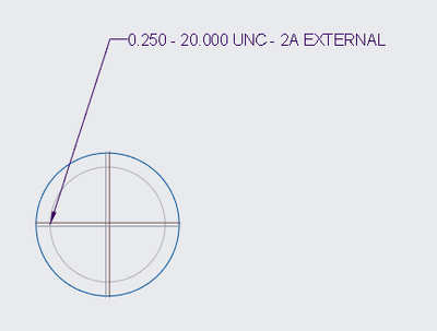

Currently using Creo 11.  I've found some posts, but no solutions.  Is there a way to automatically show external cosmetic threads in their typical format such as 1/4"-20 instead of 0.250-20?  There was a post from years ago about editing the .hol table, but this method doesn't work as somewhere along the line PTC changed the format of the hole table.  Now in the table, there is only "BASIC_DIA".  If you edit the table to say 1/4 or "1/4", a value of 0 shows up in the hole note.

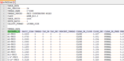

You can create your own parameters in the hol file. For instance:
DEFAULT_CALLOUT_FORMAT_DATA
HOLE_TYPE THREAD DRILLED_DEPTH THREAD_DEPTH CSINK CBORE EXIT_CSINK CALLOUT_FORMAT
TAPPED YES NA NA NO NO NO {0:&HOLE_INSTANCE_COUNT&HOLE_INSTANCE_X_SYMBOL&HOLE_INSTANCE_SPACE} &MY_PARAM_HERE
and then in the hol file off to the right you have:
BOTCSINKANGLE   MY_PARAM_HERE
60                             2-56
60                             4-40
60                             6-32
60                             8-32
60                             10-24
60                             1/4-20

No. No manual note. You define the hole note in the .hol file. You can make the hole note say anything you want and then it shows up as the hole note annotation.
Article explaining hole note call outs:
https://www.ptc.com/en/support/article/CS28399
September 3, 2025
In your hole tables, you can define the string you want to use under the parameter FASTENER_ID and call it out with the token &SCREW_SIZE, e.g.:
September 3, 2025
Can't figure out how to get my note to show up as desired.  Can you take a look at the above and point out my mistakes?

Hey @HS_9187281, I finally noticed that you are talking about external threads.
Those notes are "semi-automatically" created in the drawing mode and pull in the information from the cosmetic thread feature.
But I don't think there is a way to attach a custom parameter from the .hol file to this cosmetic thread feature.
Therefore, I don't think what you are asking about is possible.
