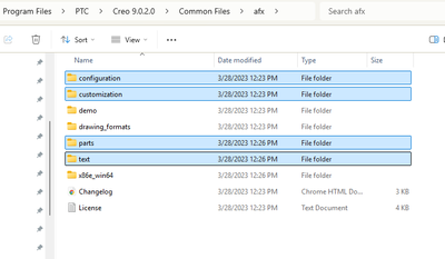

Following the instructions, I have copied the customization folder to a network drive, however I noticed that the customization folder did not contain the three sub directories (*see attached) as mentioned in the instructions--they were separate.  I tried dropping them into the Custom folder on my local copy.

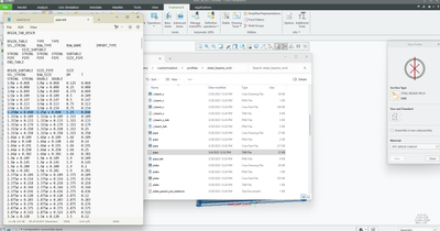

1.)making a new folder directory and then copying and editing an existing profile
2.) adding a size to an existing profile
neither has worked.
I have mapped the customization folder in the afx options with no luck.  I have also tried mapping the library path as well with no luck.

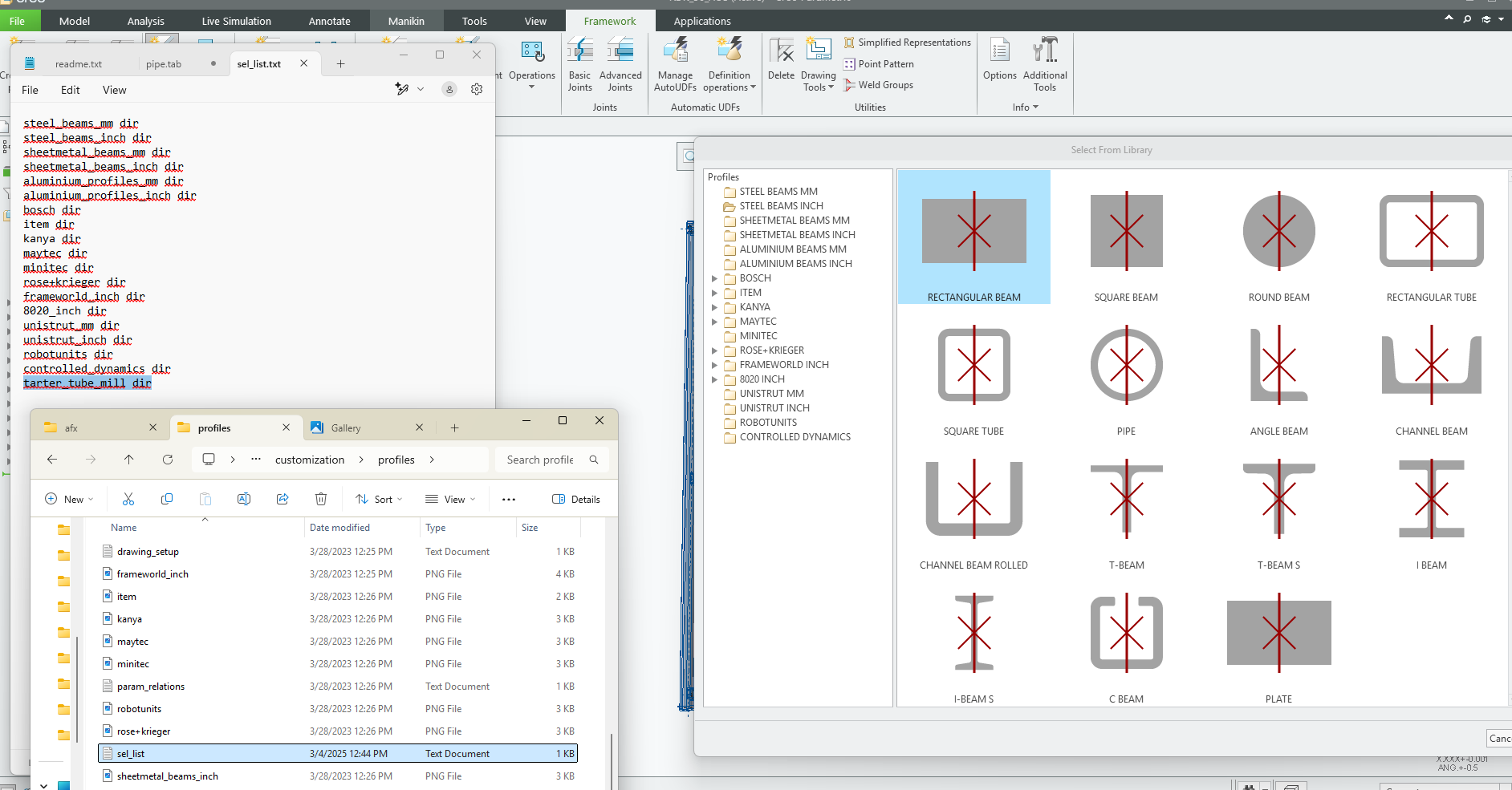

I have mostly copied and pasted the table text, but made sure to separate the table values with tabs.  I am using notepad.  I have also tried updating the sel_list with no luck.

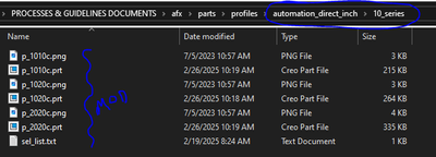

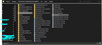

I haven't been able to get the actual customization folder/directory to work, but I was able to Copy the ENTIRE afx directory from the Install location to my documents, route my path thru their configuration options (within AFX tab) to the copied profiles folder i wanted to manipulate, I am adding my custom parts directly to the sel_list.txt, I copied the Profiles folder (in my case it was 80/20), renamed it to what I needed it to be, and manipulated/renamed the copied as i needed them.  In my case it was t-slot profiles
