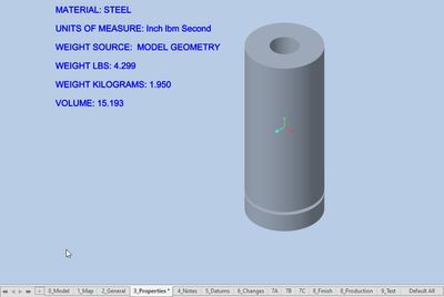

We are in the early phases of model based enterprise. Our MBE template models have several built-in flat to screen notes. If we activate GD&T Advisor application it runs a "Unvalidated Annotations" check. The only way to preserve annotation is to choose Validate All". The second screen warns of a different tolerance standard and has Delete All or Don't Delete.
Even when choosing Don't Delete" GD&T Advisor deletes ALL model notes, including those that have nothing to do with dimensioning. Having an application strip out all of our MBE template annotations is clearly not useful.

It has done it in Creo 7.0.2.0, 7.0.3.0, and 8.0.0.0. They are not flat to screen, but are notes placed on a plane we have set up that is flat to screen in default orientation. These are notes too, not any dimensions. I will open a case and include our MBE start part.
Mark
These are being deleted
