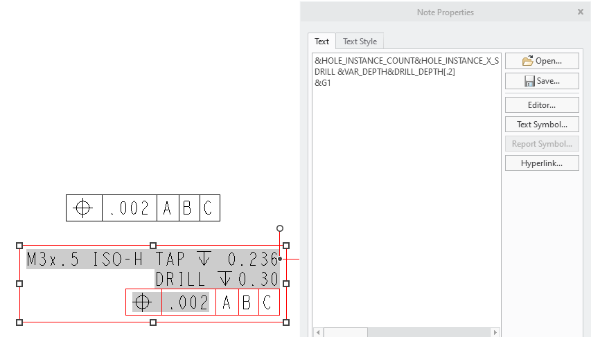

2. I'm attempting to add a feature control frame to a hole note. It's not possible and gives a very wonky result. There's no way to correct this within the GTOL.
I found this suggestion which I can't get working, and it's a poor workaround for what was functionally possible in Creo 3 anyway.

  2. That solution does still work. Yes it is clumsy, no there isn't any other really better solutions. The only other solution is to "relate to object"

Now how would one go about creating another datum feature from this feature control frame, for example from a pattern of holes (Creo 6)?
I can do this with the "Relate to Object" method, but not with the text editor method. The feature control frame shows, but the datum feature symbol does not, and you cannot attach one to the geometric callout now applied through the text editor.
For that kind of hole I would recommend using the format below:
@D
⌵&d17 X &d18
Where D is the dimension for the thru hole. You show that thru hole dimension and then add in the other dimensions in the Dimension text box. If you start with the thru hole dimension then you won't have the problem of associating the GD&T and datum feature with the dimension. It is also the correct way to do it for MBD as you can assign the sematic references.

This will not include the 4X which is required when creating a pattern datum feature (all four holes lock down 5 degrees of freedom), correct?
Edit:
I've played with this a bit. You have to first create the FCF callout without any reference (floating on the drawing). Then you can use Relate to Object to tie it to the feature of size callout. After that, you can create a datum off the FCF. You can not use Relate to Object if the FCF already has a datum feature hanging off of it.
