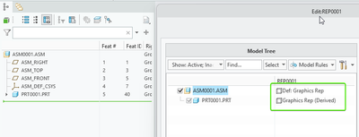

Hi I have set the option in my environement :
and it works fine by me :
here is a comprehensive article about the option : https://www.ptc.com/en/support/article/CS62681
