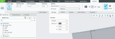

Hello i want to create a gyroid lattice body in creo educational however the representation option is grayed out (see picture). This needs to be changed to the nessecary "Full geometry" for a real body to generate. Does anyone know if this is simply a limitation by creo put on the educational version? Or is there a fix?

activate Cell Type tab in Lattice dashboard.

Hello and thanks for reply.
I hope that you know that generation of gyroid geometry is very time consuming. Also size of model file is very large.
Martin Hanák
Yes i am well aware of both and neither is an issue for me. I have a computer that can handle both generation and size.

Hi ,
Formula driven lattice (FDL)  support only Voxelized representation hence it is grayed out.
