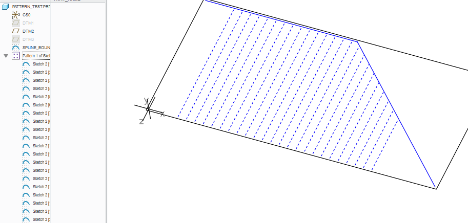

Dear Expertes,
As you can see the below image. Is there any way i can control the pattern so that the geometry should not cross the trapezoid boundry.
With Regards
Aghil.M
psobejko
(To:avijayan-2)
Try using the "convert to spline" function in the sketcher->operations->convert to->spline.
Sketch the boundary shape using lines.  Select them, and convert to spline.  This results in a single entity, that you can then use to constrain the endpoint of your vertical line in the sketch that will be patterned:

avijayan-2
(To:psobejko)
Hi @psobejko
Thanks a lot for the reply. This is what i was exactly looking for,
With Regrads
Aghil.M

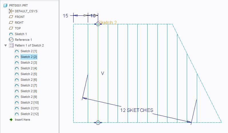

jhaston-3
(To:psobejko)
Hi, This is good. And you can use the same approach using a slightly different method ...
Create the trapezoid as a curve and use it to create a reference feature (Intent curve) from the datum drop down menu.
Now you can create and pattern a vertical curve using a linear dimension from one end.
you can investigate attached part created in CR3 M100.

avijayan-2
(To:avijayan-2)
Hello Everyone.
Thanks for the reply. All your method was helpfull.
But this task was a part of an Automation task so @psobejko  solution was more accurate for my problem.
So once again thanks to all of you for your attention.
With Regards
Aghil.M
