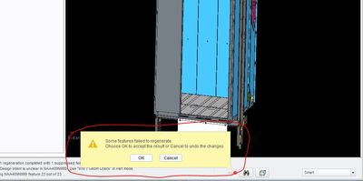

Is there any config options to hide the regeneration status box. which appears if model regeneration failed.
Please see the image give below.

So...when dealing with "cause and effect", you want to focus on the effect?
If I were you, I would spend some more time and fix the cause...
In other words, you should fix the errors in your design, not hide the regeneration status box which shows that you have a problem with your design.
I understand your point, however there are many times where I make a change that I know will cause failures and being able to bypass this dialog would be helpful in those cases.  However, in most cases, the user needs to know that they've broken something and it needs to be fixed.

I know the  cause and the effect of this issue. see in my case this design is a mixture of pro program, interchangeable assembly & Pro-Layout. In actual there is no error's if i regenerate the model 2 times its regenerating perfectly.
I am doing automation on this model using j-link so because of this pop up message i am having issue in getting handler to creo session some times. So just wanted to know if there is any config options to hide this pop up box.

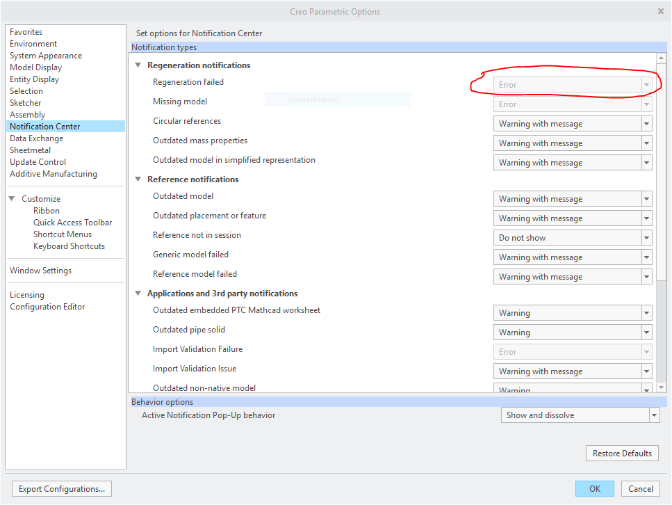

Hi @avijayan-2,
Seems like we build our models in a similar way 🙂
We also use PRO/Program (with execute statements), Interchange Assemblies (all our fastners for example), a lot of sheetmetal, etc. All driven by Excel Spreadsheets because our designs require 1200+ input parameters.
We also use j-link to automaticly build and/or publish our models (4 servers are available to build new models, or to generate PDFs, ProductView viewables, milling programs, bend programs, GEO files for lasercutters, etc.)
As for your "Regeneration notification", it looks like the "Regeneration failed" notification is disabled...
avijayan-2
(To:HamsterNL)
Hi @HamsterNL
Thanks for the reply i will check that one. I Have found an alternate solution to this by passing ENTER key through program. It is working as of now.
