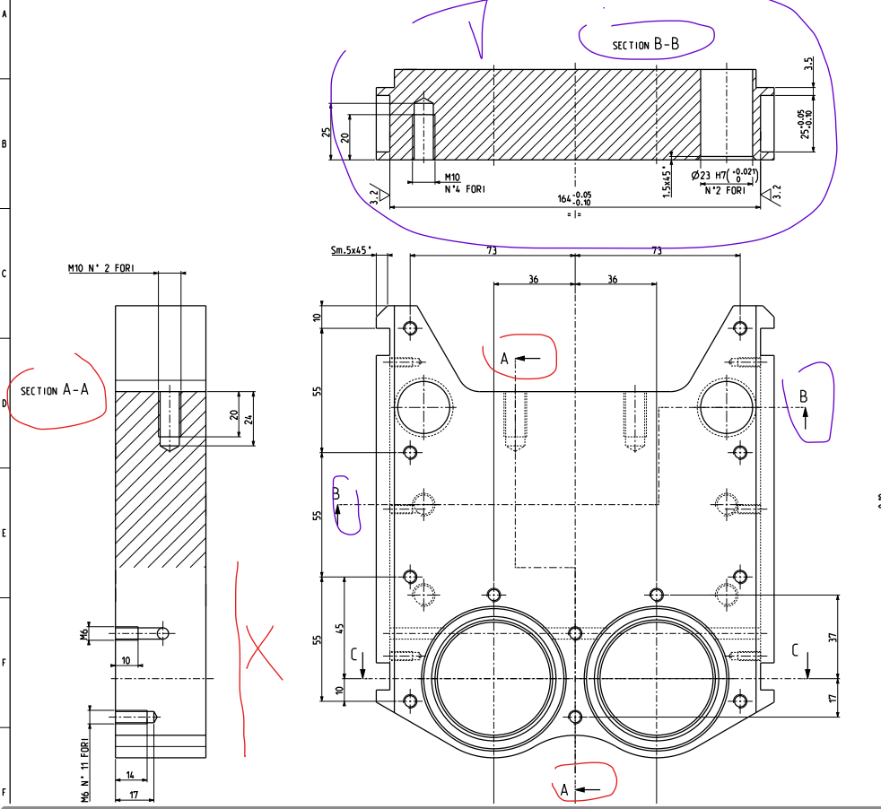

I am using Creo Parametric Release 11.0 and Datecode11.0.3.0; in a single view, the hatch of a section is not completely shown. In a different view with the same charatheristics, the hatch is correctly shown.

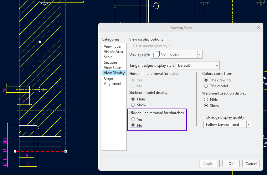

Finally I found the solution... With the option in the image attached set on "No" the hatch is now completely shown.

Hi Catalina, I forgot the image...
A you can see, the hatch on section B-B is complete, but something doesn't work on section A-A.

Try moving the bottom portion of the section line .01 to the right or the left. Sometimes when going through the center of cylinders Creo has an issue due to the splitting of the cylinder in half.
Thanks Dale, but nothing changed flipping back and forth on the other side.
