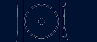

Dale_Rosema
(To:StephenW)
For me it was just a nuisance, The hatching were so spaced out you couldn't really tell they were hatched.
Small company with not a lot of standard as far as this hatching for this material and that hatching for that material.
The shop just needs to understand what is being communicated with them.
I am sure that others may see it as a big improvement. For me, I just needed to know where and how to update it.

Dale_Rosema
(To:StephenW)
.... also
not sure what the relation between the old and new spacing values.
What used to be a "0.7" spacing in Creo 4.0 is now a "3" spacing in Creo 9.
I have no idea what the spacing means on the new hatching, as far as numerical values go. The result seems to be dependent on some other factor, maybe the overall model size, I don't know.
