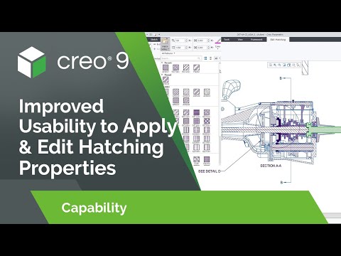

This might answer your question:
https://www.youtube.com/watch?v=ReqUS8c3dio
Hatching workflows in drawings were overhauled in Creo 9, which enables improved usability when applying & editing hatching properties of cross-section views. This includes new ribbon design, hatch pattern gallery, hatch tree, search tool, and many other contextual productivity options that will ...

The video was nice, but in today's age, they should add chapters to the video so that it would be that much more beneficial.

Converting old hatch patterns is referenced @3:35-3:55 in the video, so don't give up in the first minute.
