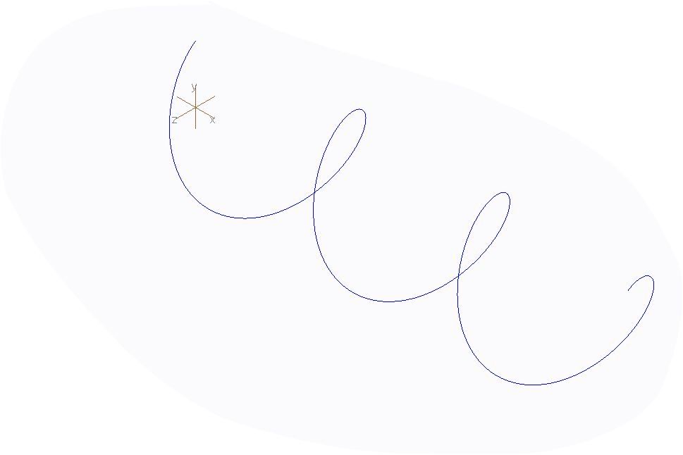

Hi, This can be done using Creo with ease!
Simply create a datum curve defined by an equation! (or in this case three equations).
The only other feature required is a csys.
Creo Helical CurveCreo Helical Curve
I uploaded this model as an example of a helical curve which is defined by three simple parametric equations...
x = 5*t
y = 2*cos(t*360)
z = 2*sin(t*360)
In this case,
The helix is projected along the x axis with pitch = 5 units.
The shape is defined by the equations for a circle in the y-z plane using cartesian co-ordinates, with radius = 2 units.
The helix is right handed.
t is a system parameter which varies between 0 and 1.
Please open the model and explore its interesting properties.

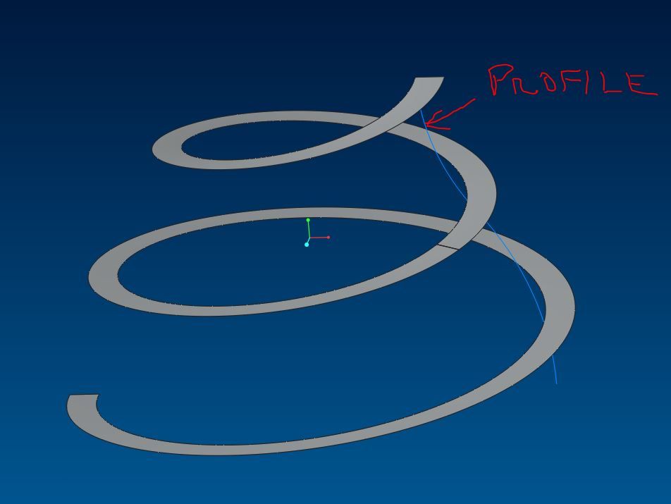

Thank you for your reply, but this does not answer my original question. I have used this method in the past, it creates a cylindrical helix, it does not follow a profile, it has a constant radius, in your case 2.
I realized after making my post that i can almost achieve my goal but i end up with a redundant surface which i guess isn't the end of the world. I figured I could just use the Helical Sweep feature & sweep a surface in the form of a straight line along my sketched profile, then I have 2 edges I can use for my helix curve.
Regards
John

Thanks for the reply, see my response to the first, I think the same applies. I have attached an image of my requirement & my solution.helix_to_profile.JPG
Hi, I tried to solve by adding another equation to the sweep. Is this something you have in mind?
John.Pryal
(To:John.Pryal)
Thank you for your reply. This is the same as my approach, the image I posted earlier was done in Creo using Helical Sweep just as you show. The only disadvantage to this method is I end up with a redundant surface once i extract my helical curve/edge. In Catia, it appears you can create the helical curve without the surface, so you don't have to deal with hiding it somehow or merging it with other surfaces.

Yes, you have it right. It is my belief that this can only be done the way you & I previously described, using the helical sweep feature to make a flat surface. Maybe this could be done by equation but it would not be worth the effort when it takes minutes to produce our way. I was just curious to see if anyone could come up with a way of doing this without having a redundant surface like Catia is able to do.

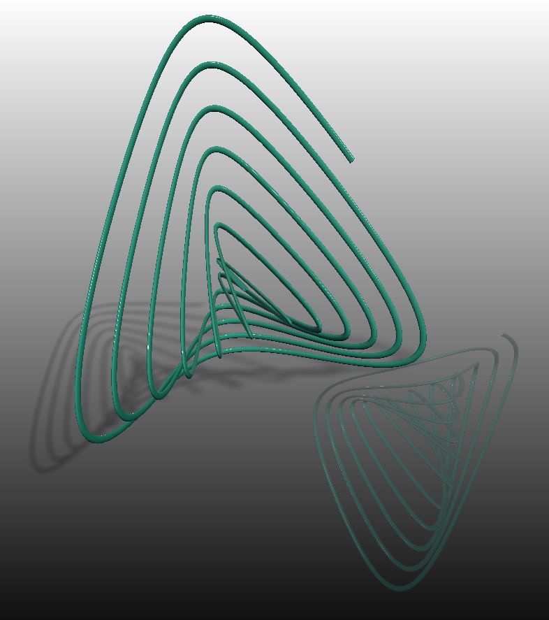

Just for fun...
x = 25*cos(t*360)*sin(t*360)
y = 2*cos(t*360)*t*(1+exp(sin(t*360)))
z = 2*sin(t*360)*t*(1+exp(cos(t*360)))
Using t between 0 and 6.25.
Creo Cartesian ParametricCreo Cartesian Parametric

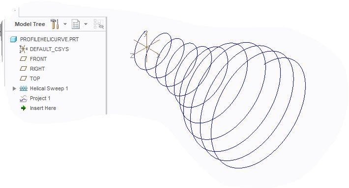

Hi, I used your method to create a datum curve by projecting the edge of the sweep surface onto the surface of the sweep. I've placed the sweep on a layer and hidden it (I don't see this as a significant drawback). Seems okay and accurately follows the profile. Only two features and relatively straightforward procedure.
Creo Helical Curve Following a User-defined ProfileCreo Helical Curve Following a User-defined Profile
I think Ken is dead right about the maths and taking the route using parametric equations. That would be difficult and time very consuming, requiring a different solution for each profile.
