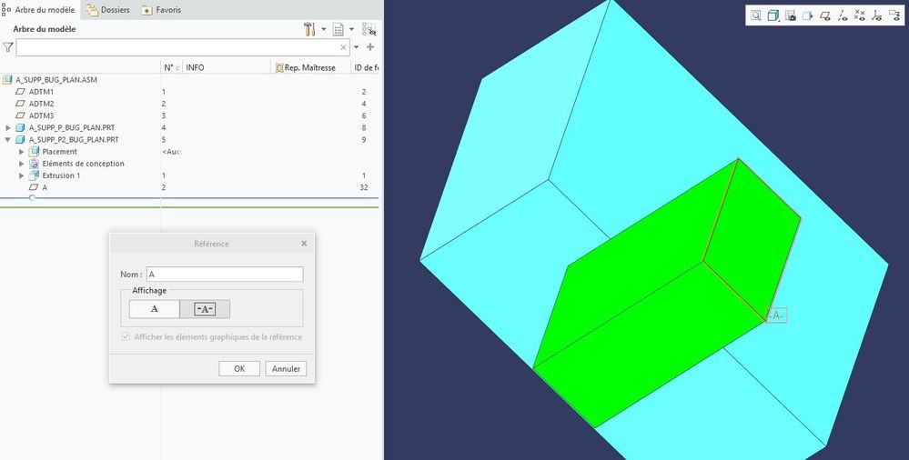

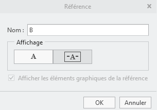

I had a problem with some assembly that were showing planes even when I had my "plans's display" off. I realise that the planes that were still showing up had a special property checked, as you can see below :
Is it possible to hide those type of planes too when plans's display is off (at least in assembly) ?
For information, when I change the display back to the normal property of the plane, the plane hides like it should but it would be great if I didn't have to.

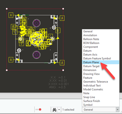

I'm not sure exactly what you are referring to either. Do you have GD&T datums showing? Maybe a screenshot of what the problem is would help.
If you have GD&T datums showing on your drawing, I usually just set the selection filter in the bottom right hand corner to datum plane and then window select across the view(s). Then right mouse button erase or delete (whichever is available)

Hi, to add more context on this subject, you can see below an example of my problem.
As you can see this is an .asm file with 2 .prt files in it, I disabled my planes but one is still showing up. This plane "A" is from the second part file and is a reference plane.

Have you tried adding the set datums to a layer and turning them off?
These have been an issue for years but I think that layers work.
Unfortunately I am not on Creo 8, so I can not test.
SR_CAD
(To:StephenW)
Hi, this is an alternative solution that I use from time to time. Either this or turning back the reference plane into a normal one.
