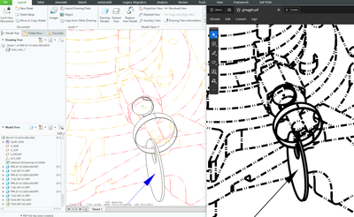

Hi Martin, hope the below images will help.
I have an external shrinkwrap in the model which is hidden, but i have it shown in the drawing as the dotted lines. When I export this drawing into PDF, the shrinkwrap does not show.
In contrast, when i have the shrinkwrap shown in the model, it also shows when i export it to PDF.
What i am trying to achieve is shrinkwrap hidden in model, but shown in PDF. Thanks.

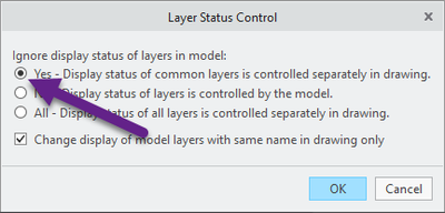

My suggestion would be to create a layer in the model and add the skeleton to that layer. You can blank (hide) that layer in the model.
I the drawing, you can leave that layer on (not hidden).
Depending on your settings, you may need to adjust the layer setting in the drawing layers. In the drawing, go to the layer tree, then tools icon, then drawing layer status...
