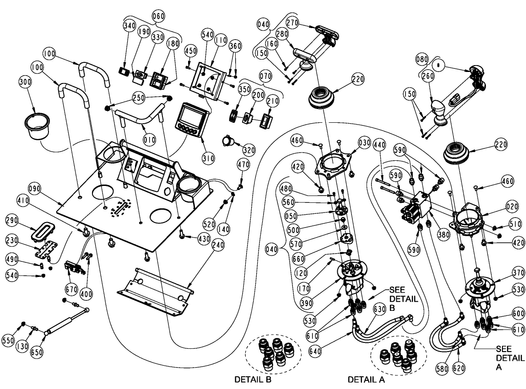

We have custom balloons that do this. That being said, in order to have the leader there needs to be a circle sketch. To get around this we have just made the circle sketch so small it doesn't show up.
UdoMin
(To:Chris3)
We did discuss the circle sketch in micro size-
although the leader follows the path to the circle.
Did you have a setting that holds the leader a marked
distance from the item number text in the custom balloon?
thanks for the reply.

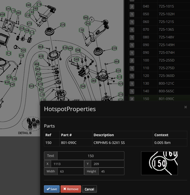

Aiming for something a bit like these:

https://landpride.sirv.com/COMPACT_DRILLS/3P1006NT/3P1006NT.spin

You really need a circle in the symbol to preserve radial attachment behavior.  The circle size determines how close the leader gets to the center, so it seems like the circle really need to stay larger than the text.  I'm not seeing any good way to hide just the circle.  Using a dot font and setting the circle to near white gets close.  One option might be to pick a color name that isn't used for anything else, and then put this color on one of the pens in the pentable configured to output pure white (255, 255,255).  Unfortunately this isn't possible directly in Creo by just choosing white since RGB values above a certain number (approaching white) will get output as black instead.

In the symbol definition, if you set the leader attachment then shrink the circle, the leader attachment will remain at the original radius.
TomU
(To:kdirth)
Wow, yes it does.  Doesn't seem like that should work, but I think that's the workaround right there!

It is definitely a quirk of the program.  I noticed it while creating and modifying a custom balloon, The leader did not stay on the balloon when I adjusted the balloon size.  Also. I noticed that the miniature balloon circle creates a very small mark on the PDF that is only noticeable when looking for it.

On another thread we typically change the out of box fonts on the call out numbers to hook the numerical ones.
Our auto hotspot ARI networks web program picks up certain fonts better then others.
It likes the 1's with a hook at the top better than the default "font" 1's... in Creo...
