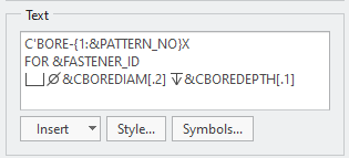

.hol hote is:
Hole text in .hol file is:
C'BORE-&PATTERN_NO{0:X}/FOR &FASTENER_ID/<CTRL-A>v<CTRL-B><CTRL-A>n<CTRL-B>&CBOREDIAM[.2]<CTRL-A>x<CTRL-B>&CBORE_DEPTH[.1]
But in Creo shows as :
Which i find it weird.

"...it seems CBOREDEPTH and CBORE_DEPTH are somewhat different in that one comes from the .hol file and one from the actual feature."
That is the reason why I am using CBORE_DEPTH instead of CBOREDEPTH in .hol setup. As for DEFAULT_CALLOUT_FORMAT_DATA i just put "CALLOUT NOT DEFINED - EXAMINE FILE ISO_1.HOL" so it tells me that proper callout is not set.
I set up hole callout in .hol file as:
C'BORE-&PATTERN_NO{0:X}/FOR &FASTENER_ID/<CTRL-A>v<CTRL-B><CTRL-A>n<CTRL-B>&CBORE_DIAMETER[.2] <CTRL-A>x<CTRL-B>&CBORE_DEPTH[.1]
and yet callout turns like this:
It is like Creo does not follow hole callout from .hol file.
