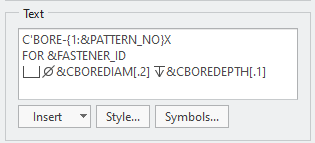

I have a strange problem that hole callout does not update if value of hole dimension change:

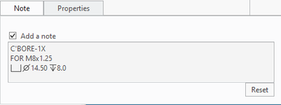

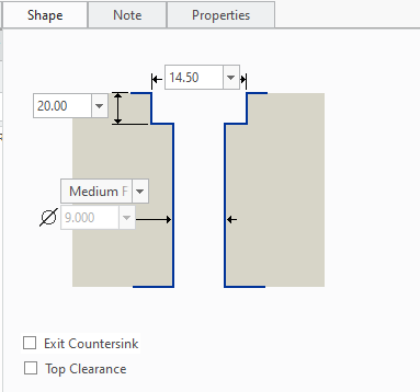

C'bore depth is 20mm. And yet, hole callout says 8mm, which is wrong:
While parameters are correct as value entered:
Hole text in .hol file is:
C'BORE-&PATTERN_NO{0:X}/FOR &FASTENER_ID/<CTRL-A>v<CTRL-B><CTRL-A>n<CTRL-B>&CBOREDIAM[.2]<CTRL-A>x<CTRL-B>&CBORE_DEPTH[.1]
As in hole annotation:
I also changed c'bore diameter value and it's value in hole callout did not change.
I am using 5.0.6 version.
Has anyone had a problem like this?

Well, your names for the hole parameters are inconsistent.
Parameter name:
CBORE_DIAMETER
in your .hol file:
CBOREDIAM
Parameter name:
CBORE_DEPTH
in your note:
CBOREDEPTH

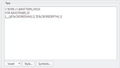

I did not make those parameters. Creo does.
.hol hote is:
But in Creo shows as :
Which i find it weird.

That is the reason why I am using CBORE_DEPTH instead of CBOREDEPTH in .hol setup. As for DEFAULT_CALLOUT_FORMAT_DATA i just put "CALLOUT NOT DEFINED - EXAMINE FILE ISO_1.HOL" so it tells me that proper callout is not set.
I set up hole callout in .hol file as:
C'BORE-&PATTERN_NO{0:X}/FOR &FASTENER_ID/<CTRL-A>v<CTRL-B><CTRL-A>n<CTRL-B>&CBORE_DIAMETER[.2] <CTRL-A>x<CTRL-B>&CBORE_DEPTH[.1]
and yet callout turns like this:
It is like Creo does not follow hole callout from .hol file.
