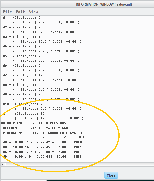

How are these datum points defined?  Try using feature->feature info and then extracting the data from the text file...feature.inf usefulness.png

Thank you, it seems good. How exactly can I get to this Information window? I tried many ways but nothing worked (I am using Creo 2.0)

I don't have Creo running right now.  But generally, you right click on the point feature in the model tree, then info->feature info.
