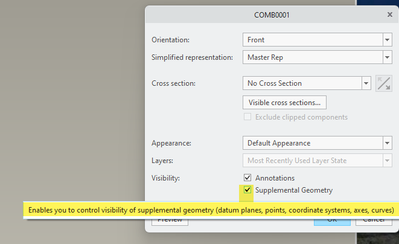

I am new to combination states. When I create a new combination state, all of my default datum planes get hidden and I can not unhide them using layers or the model tree. But I need them because I want to move dimensions to those planes. Does somebody maybe know how to bring back the default datum planes when you just created a combination state? Thank you for looking into my question!

Add the datums to the combined view where you need to see them using supplemental geometry option.
