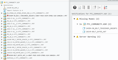

Creo tells me that embedded components in an inseparable assembly are missing:
How is this possible? My understanding is that those components are saved in the assembly file-how can they be missing?

I think I figured it out:
I was able to create this issue if I save the assembly while the embedded component is not "loaded".
You can erase embedded components from the session and if you save the assembly the embedded component disappears.
Simplified representations allow you to exclude components, and then you can call Erase Not Displayed to remove those excluded components from session. If you save the assembly in this situation, the embedded components are deleted.

The whole assembly is an overlap of two imports.
I tried to rename the assembly, and learned that embedded components cannot be renamed (via renaming the assembly) and for missing embedded components not even the reference to the original assembly name is changed.

The whole assembly only contains imports. I did not find any indication that there are any family tables involved.
I was able to reproduce this issue in Creo 8.0.8.0, but not in Creo 11.0.2.0
