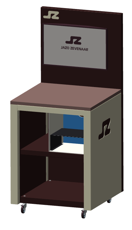

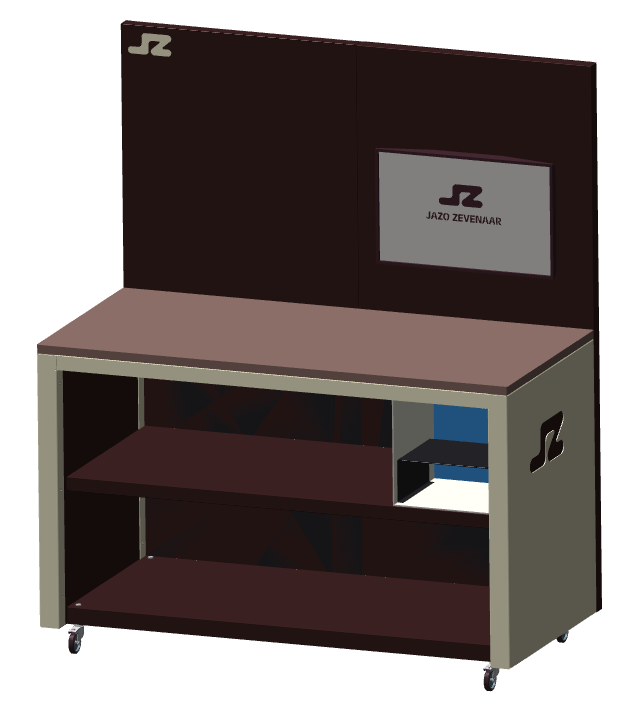

We have switched to "paperless production" in the end of 2014, so a little over 3 years now.
The majority of our working tables are mobile, but they are placed at "fixed" locations on our shop floor. If we every want to re-route our shop floor, we can easily move our working tables to a different location. The working tables are all wired (power and network), to provide the most stable setup.
We have "single" and "double" working tables. Most "double" working tables are equipped with two screens. As for screensizes, believe we are using 21" screens.
We are using the working tables to view PDFs and ProductView files, amongst others.
Double working tableDouble working tableSingle working tableSingle working table
